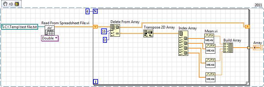

Try this.

Thanks for image programme,
But this is not the exact solution which i want,

The image can be dragged and dropped on to a block diagram. If this is not working, save the .png file on to your harddisk and then drag and drop it on to your block diagram.
Try this.

Dear sir ,
Thank you very much the programme is fine working, it gives the value whatever i deisre,
But there is little proble in the column 1 it gives machine number 2 constant, but it changes,
and it is not necessary that first value of minute  will start from  0, if start from any value so , take according to range 0-15, 16-30, 31-45, 46-59,
here i have attache my file and programme.
Message 8 of 17
(3,555 Views)
The vi gives you averages for a specific machine, you have to specify this on the front panel.
