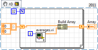

how to tke an average of value at th 0to 15 , 16 to 30, 31 to 45, 46 to 59 mins
Use it in this manner.

A not so known function is this. But it is very useful. So I
Decimate (single shot) VI
Owning Palette: Signal Operation VIs
Installed With: Full Development System
Decimates the input sequence X by the decimating factor and the averaging Boolean control. Wire data to the X input to determine the polymorphic instance to use or manually select the instance.
 As I can see your interval is constant so this funtion could replace most of the coding shown in suggestions from other 😉

Its not constant unfortunately. Sometimes two samples occur with the same time stamps even.

is it correct manner here is the programme,,

Here.

Dear sir,
I have Labview 2010 version , please send in competible version.,,
the sent programme is in labview 2011 version..

LV2010 version attached.
