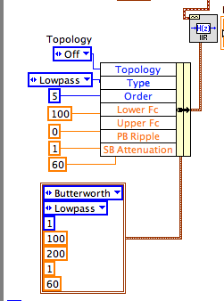

Bundle by Name requires that a cluster wire of the same datatype be wired into the middle terminal.
Lynn
