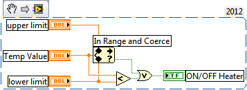

Let me give you a simple logic.

I've never used the in range tool, thank you.

Use a shift register to keep the current heater state (since you only want the state to change when you go outside of the limits).  From there, the Select function helps keep things straight.
