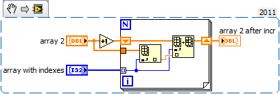

Try this:
Increment array2, but keep the values not to be incremented…
