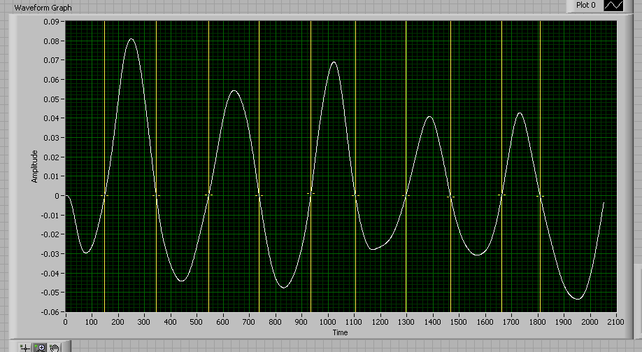

this is my 1D array.
I would like to know the indices of my array where the profile is equal to zero.
Sylvain

Your problem is noisy data, else you could do something like discussed here. Due to the noise, it could flip the sign a few times in a row.
You probably should find the approximate place of each zero crossing and then do e.g. a second order polynomial fit of all "near" data at each location.

Ha Ha!
No zero crossing in your data. I subtracted off the mean and looked for sign changes. AS Christian mentioned noise is an issue. Run your data thru a filter first to avoid the multiple crossing at or near zero.
Ben
Message 15 of 19
(4,845 Views)
For a bit of fun, I added a software filter:
I modified Ben's VI for this, its attached.
Message 16 of 19
(4,809 Views)
Re: Software filter
If the exact timing of the zero crossing is important then a "zero-phase-shift filter" should be used. Other filter can introduce a phase shift that will throw off the timing.
Ben
Message 18 of 19
(4,782 Views)
Accepted by sylvainDCU
A very good point that escaped my mind earlier, FIR has linear phase characteristics, so that should be the digital filter of choice.
