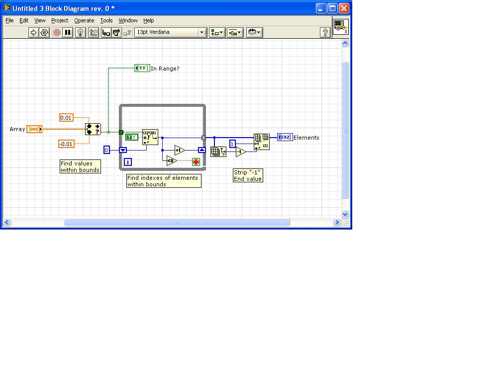

I would use 'In Range and Coerce'.
In my example (attached), all values between -0.1 < x < 0.1 will be considered zero.
It then outputs a 2D array of (Index, Value)
Cory K
Message 4 of 19
(6,574 Views)
I would try a variation of this. You can replace the Not Equal To Zero function in that example with the In Range and Coerce.

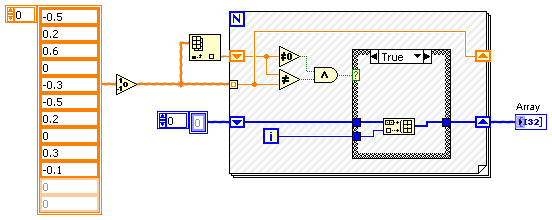

Indexes.JPGTo build on what smercurio_fc said here is a solution with comments.
Message Edited by VADave on 07-28-2009 11:52 AM
Visualize the Solution
