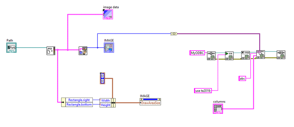

 this is the Code .

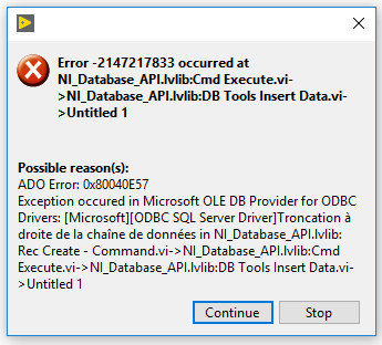

When i  trying to run the vi , I receive this error.

I found this in one old forum, let us know if it helped.
https://forums.ni.com/t5/LabVIEW/ADO-Error-0x80040E57-String-or-Binary-Data-truncated-Error/td-p/126...

Read your JPEG file in as unmodified text (rather than converting to a LabVIEW image format as you are doing) and insert that text.
