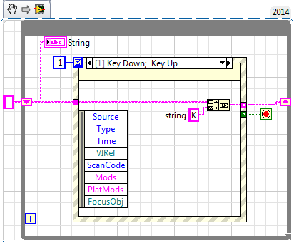

You can get this effect by using an event structure. Notice the one event that has "Key Down" and "Key Up" events. It adds a K to the string every time any key is pressed or released. You probably need to make a control sequence that identifies your foot pedal here, but it is a nudge in the right direction I think?
Can you post your code in 2013 or may be attach a snippet?
