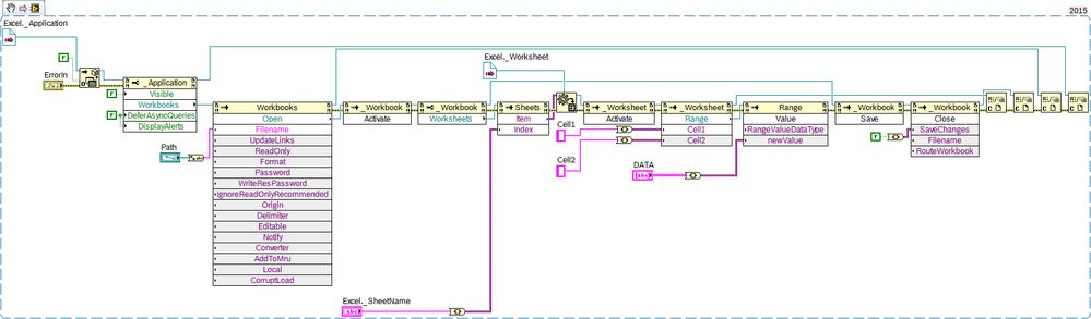

during my intership i have a project where i have to add some data to an excel file which already exist, i have to use activex but no idea how to use it, is there some vi available where i can give a file and the coordinates of cells where to writte

Try This

thanks a lot, do you by chance have the vi so that i can dowland it ?

i don't manage to drag and paste, can somebody put the VI file  please ? thanks in advance

Hi Louis,
left-click the image to start the image viewer of the NI forum.
Then you will see a download button below the image: save the image to your harddrive.
Drag the image file from your harddrive into an empty VI block diagram.
Finished.

Hi Louis,
here you go.
(You could state your LabVIEW version in your signature to aid other to provide VIs in the needed version…)

thanks a lot, but it still doesn't work but i think it is an individual error (it will probably work on other computers), when i run an error occur , and when i open the excel file after it didn't change as expected and it is suddenly only lecture mode available
the error is error -2147352565 index not valid

Hi Louis,
index not valid
The VI will select a certain Excel sheet: you have to provide a valid sheet name!

i think i gave a valid one, i used the path button to specify the file, i don't know what i can do better
