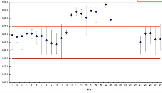

Hello guys,
Someone can explain the better way do plot a graph like the bottom one? The ploblem is the vertical "lines". Can Someone give me an idea?

Hi Paulohp,
use a XY graph. Use different plots for
- the center points
- limit lines
- bar lines (one plot is sufficient here, put a NaN between each bar)
"Better" implies a comparison. Better than what? How are you doing it currently?
Does the image show what you want or what you currently get? What is the problem with the vertical lines, they look fine.
Please explain!
(2,972 Views)
Thanks for the answer. Better than the solution suggested by GerdW. This was the first thing I thought, but there must be a better way. I tried with the pixel graph, but it will be complex to do or manipulate.Just one more thin. I'm using LabVIEW 2011.
