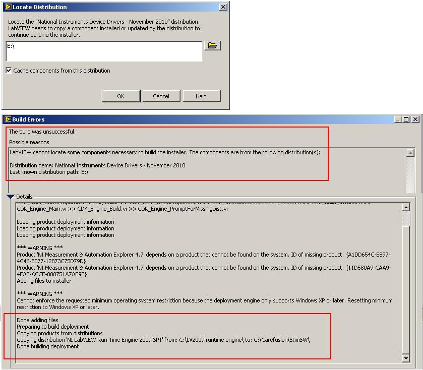

what you posted got me to read and investigate this process but there is still something not quite right.
This old PC hasLabview v 8.8 and Labview 8.2 and a little over a year ago I added labwindows CVI 2010.

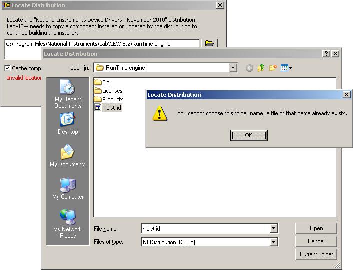

Not sure if this is causing any of my problems or not but I am adding the 8.2.1 run time engine and the
MAX usb poertion of it but when I go to build my application with the installer, it is asking me for the following and I can't seem
to find what I need to build this successfully.
Not sure if you can tell by the picture below, but I am not sure what I need to do to fix this...
Any ideas what file it is looking for and where I need to point the installer to find it?
Message 3 of 14
(3,904 Views)
It's looking for the Device Driver DVD. You selected a device driver to include in the installer and it needs to find it. You obviously installed the Device Driver DVD at some point - otherwise your hardware would not work and the messages are telling you used drive E to install. Get the LabVIEW distribution DVDs back or download and install the drivers from NI's site. You will need all of the drivers that I mentioned. I have no idea what you mean by 'MAX sub portion'.

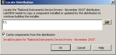

Also, I forgot to mention that if  I attempt to steer this install to a folder and a file, I get the following:
Message 5 of 14
(3,899 Views)
That makes no sense. You are being asked to locate the original DVD distribution and you are pointing to a folder that obviously does not have it.

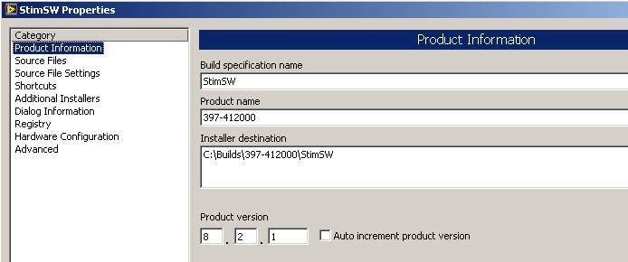

Thanks for the info...very helpful!
I am getting closer now. I loaded the 2010 CVI SP1 device drivers and this time the installer is not asking for
files. The build completed without errors and then I copied the folder with the installer and ran the setup.exe on
a NI virgin system. The install seemed to work OK as no errors were reported and it had requested a reboot after it
was finished.

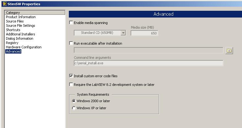

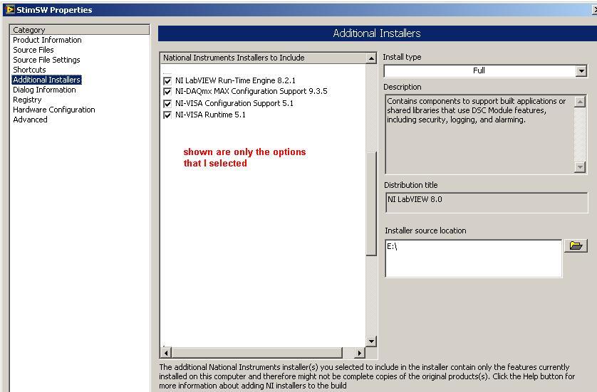

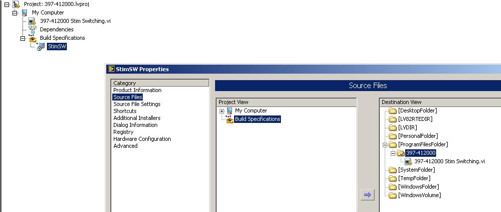

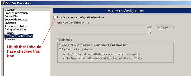

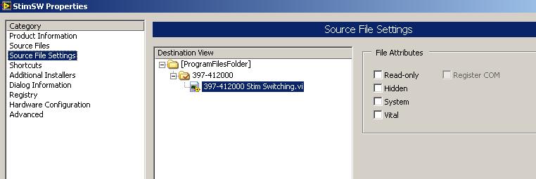

After the reboot, I see a folder containing my vi but no executable. Below are some screen shots of how I set up the installer.
What am I doing wrong?
Message 9 of 14
(3,874 Views)
Yes, you need to check the box to export MAX configuration or go into MAX and run the export utility so that you can point to the configuration file when you build the installer.
You've got the option to include custom error codes. Did you actually create the file for this?
