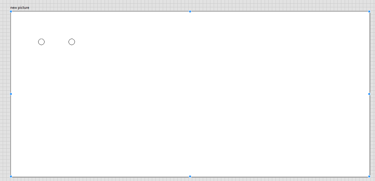

i dont know how to draw arc between two circle. i used picture control toolkits. here i attached the picture.curve.pngcurve1.png
Message 3 of 8
(4,499 Views)
Hi Annie,
instead of drawing circles you should actually draw arcs!
And WTF: there is a function called "Draw Arc"… 😄
