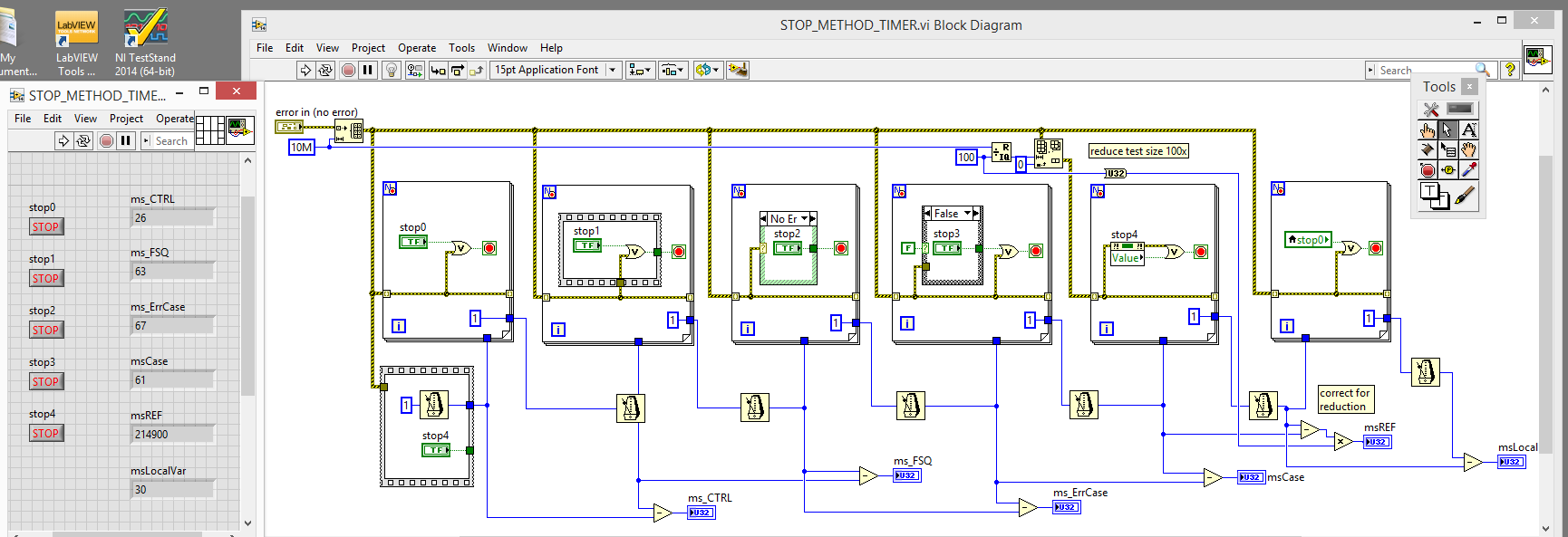

They are Test Methods for IP. So no, I can not share the APP.
The Event X close suggestion is useful. I will have to try it some time. Right now, I have no need for it.
I want to avoid using the ABORT button, and do error processing, hence the queue redirection to Exit State.
Anyway I did do my own testing, and feel like I'm goofing off....
