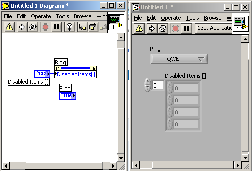

Just write an empty array to the "DisabledItems" property to enable all items.

Well, I have a Dialog ring, and the user selects items. Each time the user select an item, that item become disabled. But, I would like to do the following: I would like, the user could select the disabled item and make it enabled in run time, but I know this is not possible to select a disabled item.... but I need to do something like this, something that allows user to enable a disabled item in order to select it.
