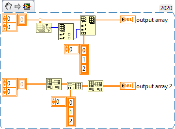

Use an Insert Into Array, or Transpose:

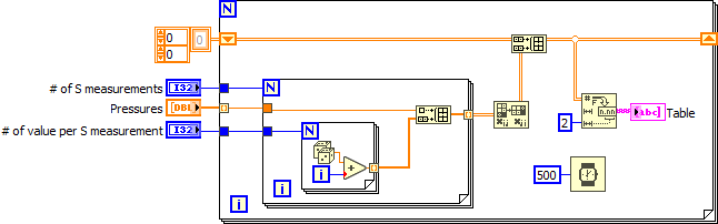

See if this can give you some ideas. Just substitute your hardware IO in the right places.
Message 7 of 34

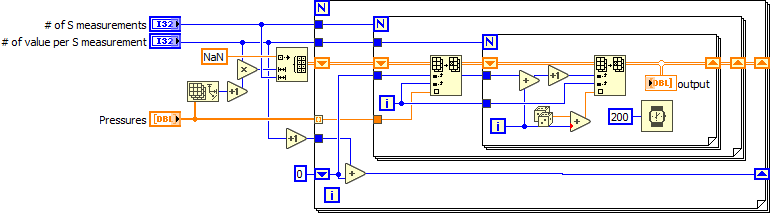

Since you know the exact dimension of the final output, a more efficient way would be to initialize the final array before the loop starts (e.g. with NaN) then replace with measurements as they are acquired. Now you can even update after each S measurement if this is desirable, depending on the speed of the instrument response.

@altenbach wrote:
Since you know the exact dimension of the final output,...
Here's how that could look like. Make sure you fully understand each details! Depending in the measurement speeds, you could also place the array indicator one or two loops out.
After the loop you could save it to a text file.
