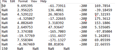

So the results end up looking like this.. I wasn't sure whether having the results appear in this format is preferable?

Sorry, I'm confusing matters. I know the data format with the 5 columns is preferred for me for post-processing. I wasn't sure whether in terms of memory allocation or CPU usage I had vaguely heard it's better to produce results in row's and then transpose (I'm not being clear here because I lack that understanding). Nonetheless I want the array to be formatted with 5 columns and 10 rows for each of the 8 rounds of measurements.

Could you see the solution to my current situation of overwriting the column of values completely as in the below image:
I've attached the VI with a slightly cleaned up front panel for reference.
If the data ends up in the wrong place, it is obviously caused by the way you are calculating the indices for the replacement operations. You definitely need to define the problem better because you don't say what it is. Do you want to overwrite or not overwrite? If you don't like how the data is arranged in the picture, you also need to show how you want it arranged.

Accepted by topic author Footballbag
The problem is that you cannot replace a 1D array in a 2D array and specify both indices. Thus you always replace the entire column.
In order to specify row and column indices, you either need to wire a scalar or a 2D array. In your case you would create a Mx1 2D array (And transpose if you want a column array) and replace at the desired locations. Here's a quick draft to demonstrate. I had to take out all your IO, but is should be easy to adapt to your problem.
Modify as needed.
