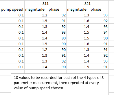

Thanks for the VI it's proving helpful. I have been told that it would be better to have the final array in the following format:
The example pictured being 1 round of measurements for the first selected pump speed.
I need to think about how I will append the current round of measurements to the end of the previous one so as to keep all S-parameter measurements in the same column (well row which will then be transposed at the end).
Also I want to attach the pump speed value setting to each row of data points as pictured so the results can be easily processed.

You can use a table with a single header with the following elements:
"pump speed", "S11 magnitude", "S11 Phase", "S21 magnitude", "S21 Phase", etc.
(note that you cannot merge cells (e.g. your current S11, and S21). Write the headers using a property node unless it it always the same..
As I already said, you probably know the final array size, so initialize a 2D string array of that final size with empty strings for display in the table and keep it in a shift register. The positions of each value can be calculated form first principles so just replace ech empty string with a real value as it is acquired.

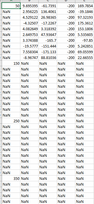

My issue with Replace Array Subset is that I would like to place my 1d arrays of 10 values after every loop below the set that have just been recorded for each of the 4 columns rather than replace them in the same position. I'm not sure whether this is advisable approach as it doesn't seem obvious yet how I do this. Attached is my results after measurements have finished being taken. Only the final 4x10 values are left in the table. I thought that I could maybe specify both the row and column index for the top value but that specifies an element rather than the first value of a 1d array. As an approach I realise that doesn't make sense. Any clues as to how to make this work would be welcome. Thanks.

Hi bag,
Attach your code so we can debug and discuss it!
An image of some Excel worksheet doesn't make a lot of sense in a LabVIEW programming board!
