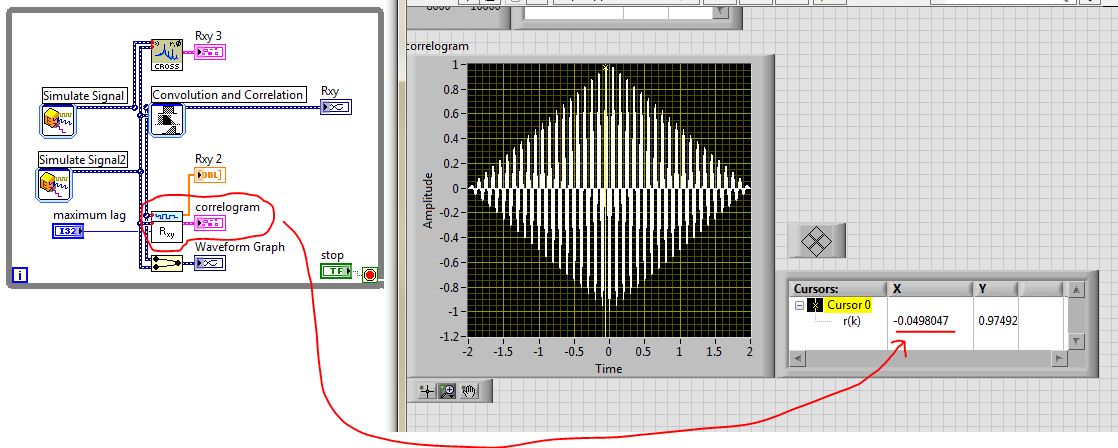

Hey guys, how can I find the maximum position in the correlogram, i.e., at -0.0498047s? I try to use "array max and min" but unfortunaly it gives the maximum position in other format. Capture.JPG

What do you mean by "other format"?
Array max and min will give you the maximum and mininum values, and the indices they occur at.  Use that information with the cluster of data that is into the chart.

The correlogram is wired to an xy graph (looks like a cluster with an x and y array). Once you find the max y, you can find the corresponding x value by indexing the same position in the x array Can you attach your VI?

Try something like the attached.... modify as needed.
