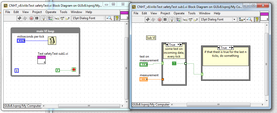

I wonder how i can store data within a subVI when the iterating loop (an thus the shift registers) are in the mainVI (or in my actual case, four levels up in VI calling).
so far i solved this with a global array variable , but i feel this is not the way to do this. what is the best way for this?
Thank you for your advice!

To store data within a subVI you should use shift registers (or feedback nodes) IN the subVI.
There is no "best" way - you need to look for appropriate ways!
- functional globals aka action engines
- notifiers
- global variables
- DVR

Feedback node! thats what i was looking for!

Hi OPCler,
in times before the feedback node we used to use while loops set to iterate just once to hold a shift register…
