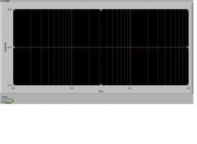

i made an XY graph with X axis in logarithmic scale. I need a graph of current graph from switch ON to OFF condition of heater supply. inital time it takes around 4A and at a stable condition it takes around 1A . it is drawing a graph wrt time of log variant. at the end save the graph as jpeg format of image depth 1( means BW graph image) write to image palette i am using.
but in the image there is no minor grid. it saves only major grid . how to show the minor grid in the saved image.
One example i can show you( actual one i cannot show)
This is the difference between the graph and saved picture. Please help somebody
if the image depth is to be increased it gives a color picture, i need bW picture for including in the test report

Right click on the graph, go to "propeties", go to the scales tab, try changing the display colours of your major and minor axes on the graph. It may be as simple as the display colour for the minor scale is being converted to white in the colour to B\W conversion when you are outputing the graph.
(I think I remember having the opposite problem, and having to change the colours in order to ensure they disapperead when printed. (dont forget to change the tick type to distinguish between major and minor in the B\W mode).

it is not working. I tried a lot but still same. Please give another solution or idea

the problem with BG color only. itis to be just changed from black to any other color. It will show the minor grid in saving and printing
