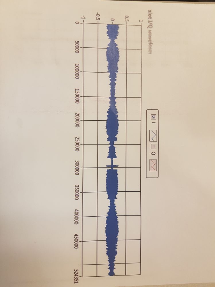

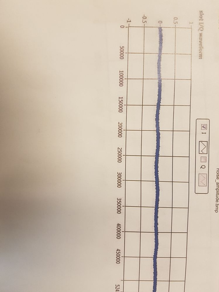

Has anyone ever had issues regarding the NI mmwave transceiver on the issue of a sinusoid noise being generated on the transmitter side and this is unnecessarily modulating the sent data. It seems to be a Local Oscillator Leakage issue, can anyone discuss more on it. I've attached images of how the received data looks and just the received noise alone. Data modulated by the noise. This noise is being produced by the txData modulated by the noise. This noise is being produced by the tx
