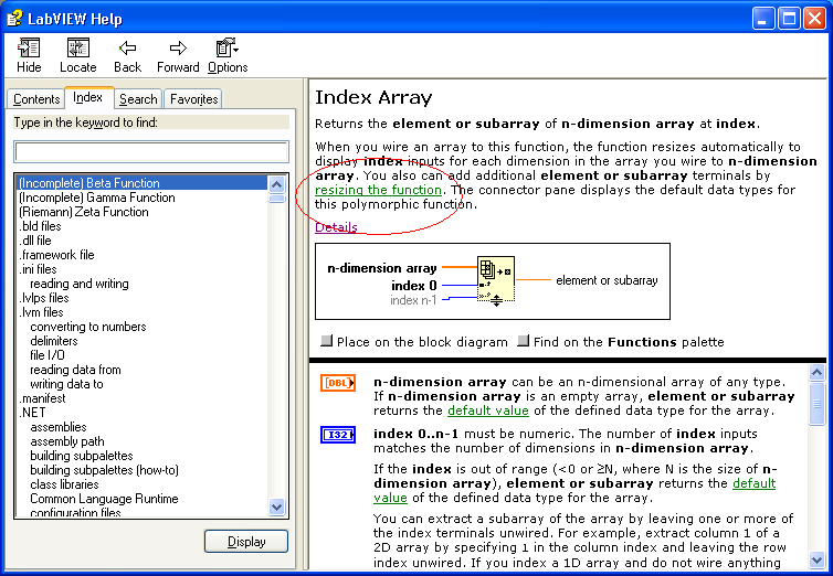

Hey Guys,
I just have a small problem working with the index array function. I want to know how I can change the index array function to get the new rows in a different file? I'm working on three plots. I want to plot all three of them into one xy graph. Almost like multi-plotting.
Thanks.
Message 7 of 8
(4,261 Views)
You've posted to an old thread and it's not exactly on subject.
As mentioned earlier, to resize the Index Array function, just look at the on-line help as shown below. When your mouse moves over the grab handle at the bottom of the function, you should see the other image. Just drag it down. Simple. With context help turned on, when you move your mouse over an XY graph, it will tell you exactly how to create a multi-plot.
