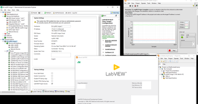

I have just tried to use newly released myRIO tookit 2021 work with LabVIEW2021SP1, I can't get them work together.

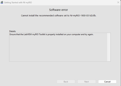

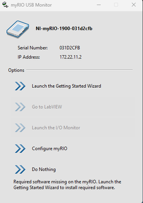

from NI-Max, it looks everything fine(figure1), but when I try to connect and config the myRIO, it returen error read "Ensure that the LabVIEW myRIO Toolkit is properly installed on your computer and try again."(figure2)figure2figure2figure1figure1

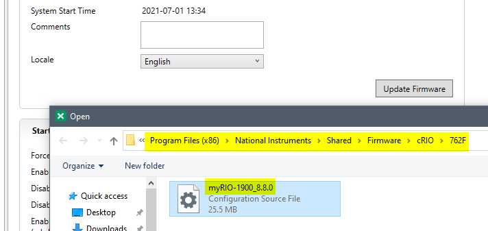

Have you tried updating your RT firmware?
When i upgraded from 19 to 20 i had to instal RT linux version 20 in MyRIO

Yes, I did it as below.
but still said missing sw.

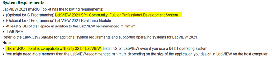

I checked the LabVIEW 2021 myRIO Toolkit Readme
it reads that LV2021SP1 32bit will be supported, but seems not.
