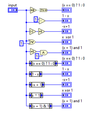

Because choice is so much fun, here my "limited" selection of options:
Caveat: they only work fine if the input is guaranteed to be in the range (0, 1). Other values will cause different results, some of them more intuitive than others. This is where Christian Altenbach's post comes in: we need to know the conditions and requirements for a proper selection of the various options.
And the -x + 1 only works for signed integers. The -x node refuses unsigned integers on its input, a sensible limitation. Interestingly the formula node version of this does not only not have this limitation but effectively still produces the right result. Apparently it promotes the value to a signed int internally and then converts it back to the input data type.
And I think I discovered a strange bug in the snippet generation. This is the actual VI block diagram from which the snippet was generated:
Anybody can notice the difference in two of the indicator labels?
Isn't it just a simple LabVIEW rule: Don't have two indicators or controls with the same label?

@UliB wrote:
By the way I see four differences.
It's not something that is normally enforced. Yes, if you create new controls they will be made having unique labels but nothing prevents one from renaming them back. Seems the snippet tool is kind of recreating the diagram in the background through scripting to get the VI code. Possibly because I did not save the VI?

Yes, LabVIEW is doing something with the code of the snippets. As you can see in my post here, at recipe 06 I overlooked the change of labels 😫, later I  tried to give these labels unique names by a leading underscore, hidden (well, badly) by the terminal, as can be seen at 07 & 08.
A space will be trimmed and the label will then be renamed.
