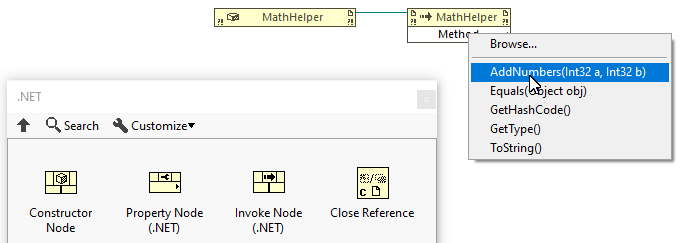

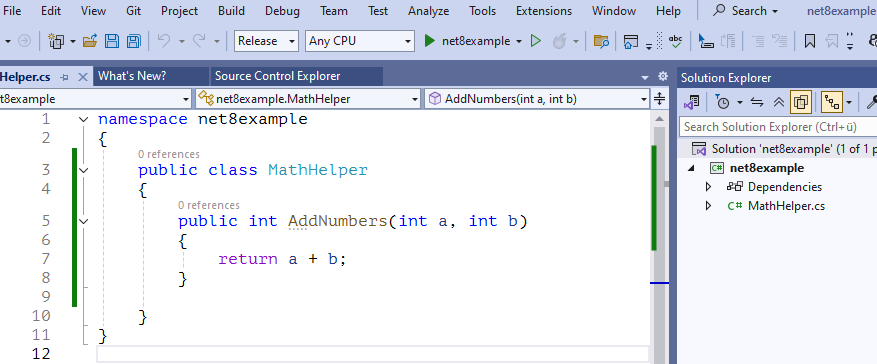

Accepted by topic author D1140
@D1140 wrote:
as per 2025 Q1 release says it support .net 8 aasemblies. but it is not supporting.
Yes, it is supported.

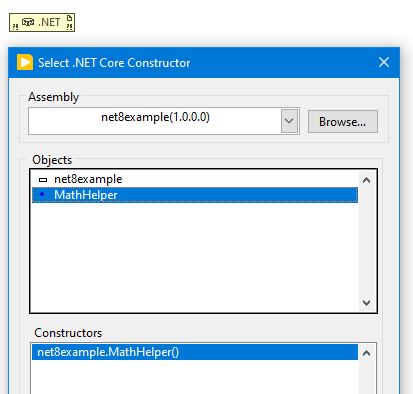

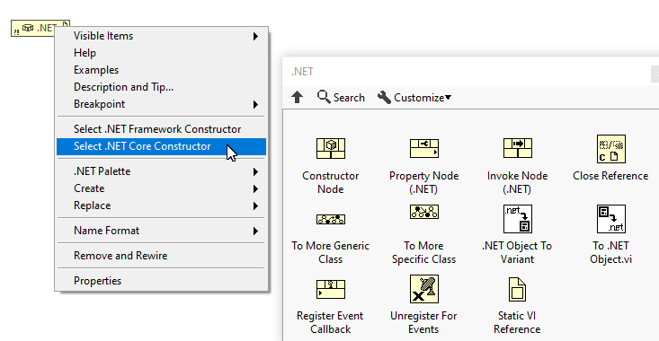

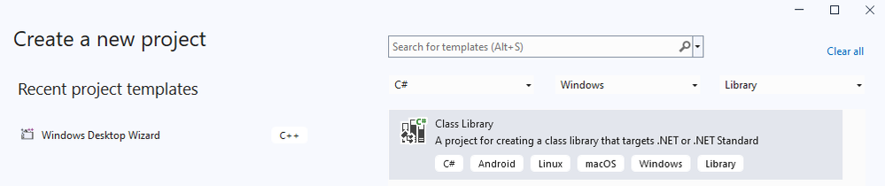

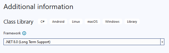

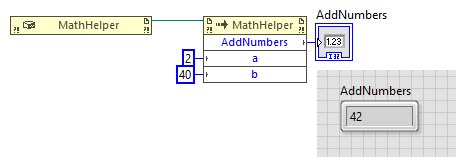

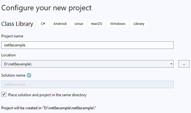

Step by step from the scratch, using Visual Studio Professional 2022 v.17.13.6:
image-20250417082546767-1744871147673-1.pngimage-20250417082546767-1744871147673-1.png
8.0:
as you wanted:
Then using LabVIEW 2025 Q1 (64-bit) v.25.1.2f2:
That is.
Message 9 of 10
(5,343 Views)
Its working thank you for the solution. Here i am not selecting .net core constructor. thats why i faced issue.
Message 10 of 10
