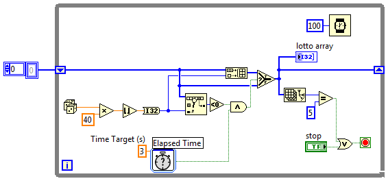

  • generate random #s up to 40
  • search 1d for non repeating #s in the shift register
  • AND the results with the elapsed timer and build the array
  • array size = 5, stop vi.
There are several problems with your version:
  • You are creating random numbers 0..39 instead of 1..40
  • Since the elapsed time resets whenever it expires, it will take 3 seconds longer whenever a duplicate is found. For example it will take 6 seconds between numbers if a duplicate is found on the first attempt and 9 seconds if two duplicates are found, etc.
  • You are creating random numbers every 100ms, but discarding everything until the time has also elapsed.
here's a quick alternative of your code.
