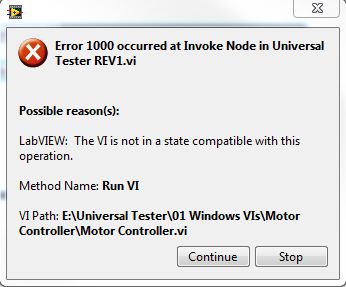

I get an error when trying the invoke node method.
The VI called out in the error is the sub VI that is being called from the main app.
Any idea on what could be causing this?

Is your vi already running when you call it using this method?
It might be running with its panel closed.  You might want to add another Invoke Node for Front Panel Open (FP Open).
I think I mentionned that you have to close the reference at the end, when you exit.
But typically error 1000 is because the VI you are calling is already running.  If you want multiple instances of the same VI to run in parallel, you have to make it re-entrant.
