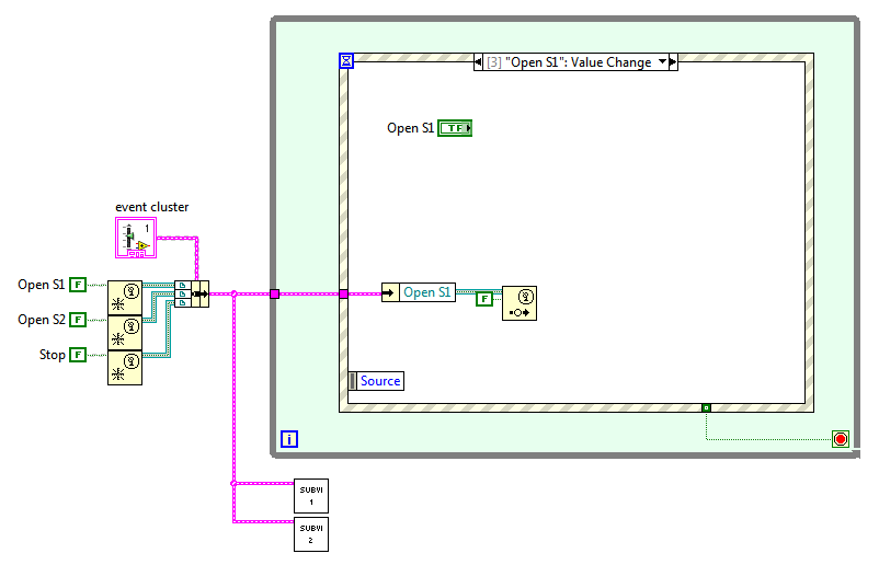

Given the following block diagram, please identify the ā€œprogramā€ inside the event structure.
steve

You are triggering a user event inside the event structure? 😮
And I would assume that you have event structures inside the sub-vi?!?  😮 😮
Yikes..
Yikes..
I don't see any issues with the way Steve is using events. I regularly fire events from within an event structure. I have not run into any issues doing so. Why do you claim generating a user event within an event structre is problematic?

It is an unusual approach, where you need to be careful that the sub-vi's event structure does not cause a deadlock.
If it is well implemented there is no problem.
I recall a post on these forums where the person had created such a deadlock.  Maybe I get jumpy when I see such implementations on the forum..  šŸ˜„

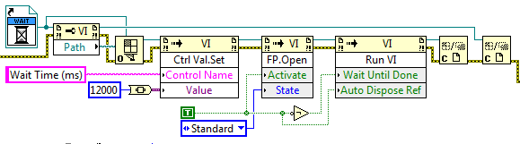

So I have something similar that I am trying to do but I get the same error when I try to call the same VI a second time.  The subVI pops up with a progress bar on it that goes from 0 to 100 and it displays the number of seconds left as defined by the user's input (the example just has a constant).  In any case once it counds down to zero it ends the loop in the subVI and closes the front panel.  Then as you can see below in the code I have been using to call it - I close the references.  Now I can't figure out why it is still running after doing this.  The front panel of the subVI will not close until it gets out of the while loop and the only things after that are a close front panel method and a close reference.  Then the VI should stop running I would think since there is no more code for it to run.
Below is an example of the code I am trying to use to call the subVI.
Message 18 of 28
(1,442 Views)
Actually as I've been trying to figure this out I noticed that if I run the main VI with highlight execution on there is no error, but when I run it without highlight execution there is.  What would cause that?
