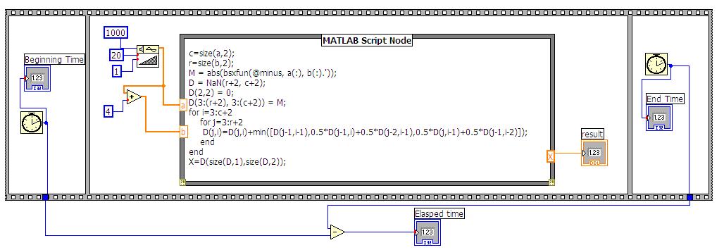

I  had make a VI, but its very slow... I wan't to optimize it. Any idea how? maybe the Matlab script, or solve it not with matlab, or how?

Try to use the MathScript Node instead of the MatLab Script Node.

Hi Kolos,
even better would be the translation to "pure" LabView code Smiley Wink
In my (just basic) understanding of MatLab scripts this seems to perform an 2d averaging, which can be done by using subarray multiplied with an array constant... (Or maybe there is already a LV function in the mathematics palette?)

I had try to "convert it" into labview code, and it's much faster now, but  in a part i had locked...
Any idea how to solve it in "pure" LV code ?
