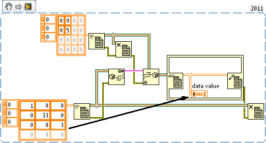

Second question answer is yes, conversion from data value reference to string (flatten and back) works, reference is not lost.
Message 5 of 10
(7,372 Views)
Inside the same VI it works, sure.  But I don't think it will work between different applications and their respective allocations of memory.
