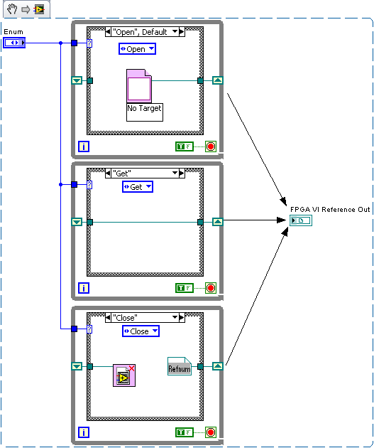

I always use a FPGA handler with appropriate API VIs to access the reference from multiple VIs in my code. Works fine and by using API VIs for Open/Get/Close you can easily find the "producer and consumer" of the reference in your project.
21009i826DDEF18E92A772
Cheers,
Swen
