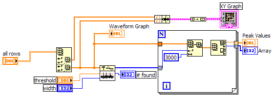

Accepted by topic author bala1234
This will give you peak values without filtering. You could get the time with a little more coding.
Tim
GHSP

I set the threshold to 8 and the width to 300. Got the peak values of 16.5178, 18.8016 and 23.8797.
