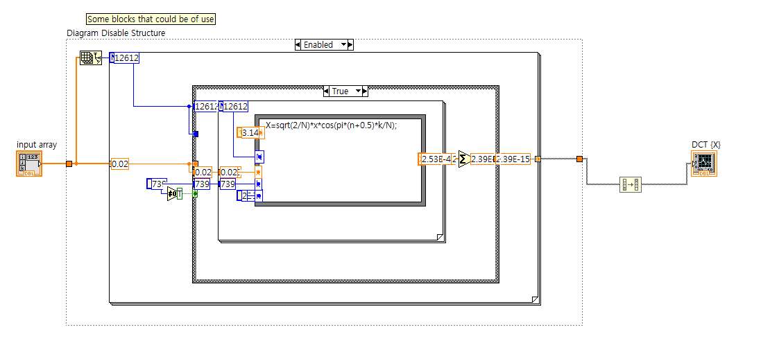

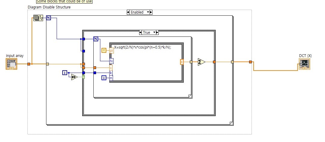

I want to fill the blank in "finish the dct block"
this is the problem.

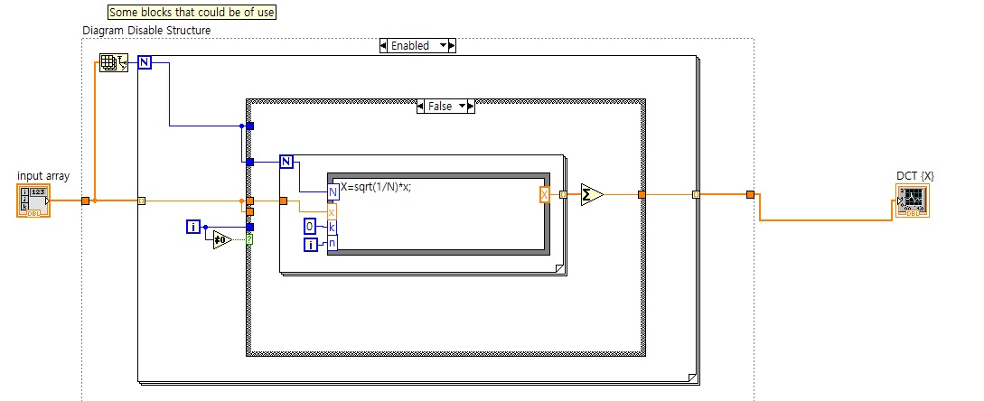

I think I almost come. However, If I tested DCT, then waveform goes to zero values except t=0( false case in block diagram)
please let me know how can I get normal waveform??
