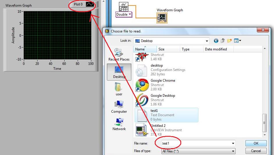

good morning. i would like to know is it possible than when i open a text file to be plotted as a graph (from pop up directory) the plot name to be same as the file name which i opened. for example when i open file (test1) to be plotted. the plot name on the graph will be test1. the file name is not fixed. thanks

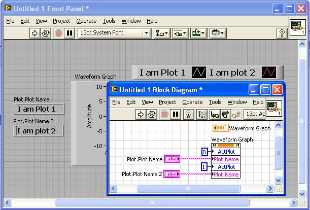

Its easy
Balaji PK (CLA)
Ever tried. Ever failed. No matter. Try again. Fail again. Fail better
Don't forget Kudos for Good Answers, and Mark a solution if your problem is solved.

hai ,
thanks for the reply but that is not the solution that im looking for . the real problem is when i click the file name from choose file to read this name should be the plot name. plz refer to the picture below . when i choose the file test1 the plot name should change same as the file name(test1).
thanks
shamaran

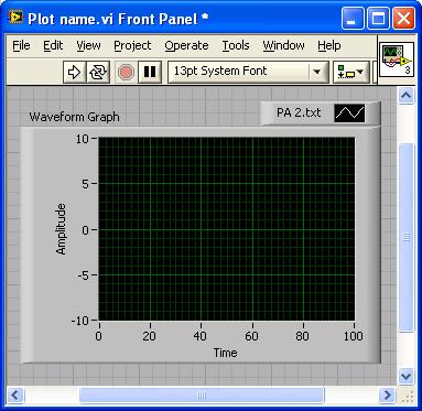

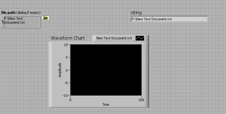

You need to get the file name from the file path and give as a plot name.See the attached example.

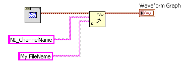

Another possible approach for naming plots could be using waveform datatype. The waveform datatype includes attributes which could be read/written by get/set attribute. The attribute for the plot name would be NI_ChannelName.
hope this helps,
Norbert
