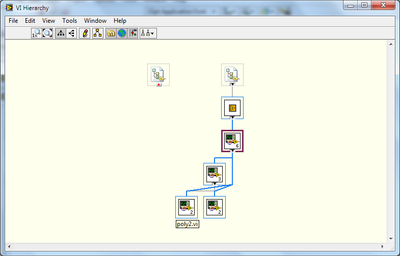

Intaris, I believe when you place a Polymorphic vi on the block diagram, entire poly instances are loaded to the memory. This you can observe in VI hierarchy of the FPGA vi. which might causing you the broken arrow.

Vsh,
I can appreciate that they are loaded into memory but I question as to why the compiler tells me that VIs which are NOT being called lead to uncompileable code.  I see a difference between loaded VIs and USED VIs, even if perhaps the LabVIEW IDE does not.
If this is the only way the IDE can work then it's something I just have to take into consideration in future.  I really think it shouldn't behave in this way though.  In a perfect world.....
Shane.

Shane,
Polymorphic VI is like a VI which has a case structure and you place different subVIs (instances) matching your datatype inside individual cases. If any of the subVIs inside case structure is broken or the target does not support functions used in that sub VI, you would still be noted as uncompileable. (Eventhough the sub VI is never called and you have connected a constant value to case selector. which is the scenario with Polymorphic instance that is been called)
Only advantage of Poymorphism is that it can adapt to different datatypes. but all other instances are also loaded into memory as part of the Polymorphic VI. Since the VI is calling a subVI which is not compatible with the target, broken arrow is quite normal.
Well, sometimes you have to accept, thats how LabVIEW works Smiley Happy
