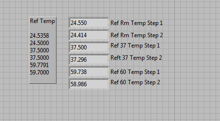

i did the same method in labview but my numbers dont come out right.
i am thinking that my setting is wrong with the precision of the format?

yeah. i tried that too but it didnt come out right.
the last number is way off

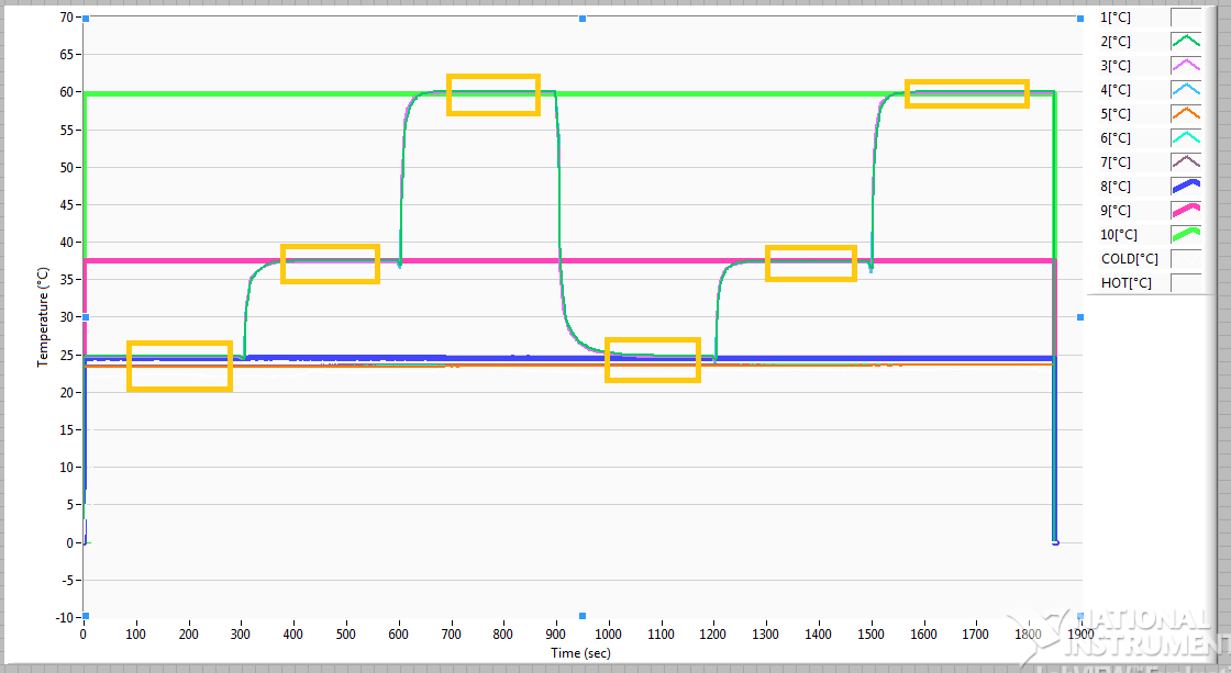

Hi
can you tell me if labview is capable of analyzing this data?
i took the average of 200 elements from
100-300
400-600
700-900
1000-1200
1300-1500
1600-1800
thats because i have seen the graph and took the average of those points
(manually)
is there any way labview can look through a column and take the average of the points BEFORE THE CHANGE in temperature?
