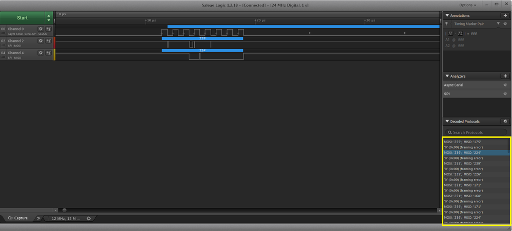

I output 0xAA but, the output is not.
My USB-8451 output 0xAA and my stm32 output 0x60.
But when I check the data using logic analyzer, the data is strange.

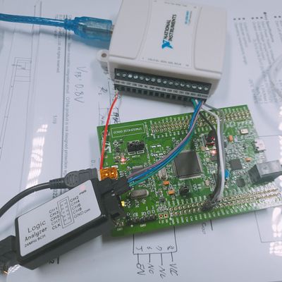

This is my hardware connection.

I think you should only use USB-8451 and the logic analyzer without stm32 because you're not sure there are no problems on USB-8451 and the logic analyzer.
you should check MOSI pin with USB-8451 and the logic analyzer first, and then check MISO pin with all instruments that you have
I think SPI CLK is well measured. so can you try to change ch0 to ch2? this is just for ensuring ch2 in the logic analyzer is not broken.
and how was USB-8451 GND connected with the logic analyzer GND? it seems the red line is only connected with your stm32.
