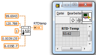

Hi Torb,
What exactly is your problem?
Well, you can even wire all of your constants:
What was your problem?

thanks for responding,
Well...first of all i was not aware that RTDVoltage could also be the resistance you measure.
"RTDvolts is the voltage you read from the RTD" in the helper made me kindof confused.
On the other hand this converter does not include the "C" constant witch I need in order to make the pt100 correct from -70 and up to 200¤C.
I will also have to make a function that selects a formula based on above or below 0 later on, but one step at a time.
I was trying to make the above 0 formula work first, and i got stuck.

Hi Torb,
first of all i was not aware that RTDVoltage could also be the resistance you measure. "RTDvolts is the voltage you read from the RTD" in the helper made me kindof confused.
R = U/I. Ohm's Law!
When you provide a value of 120 to that routine you need to set the Iex value according to this: 120V = 120Ohm * 1A…

The simplified Callendar equasion implemented by the Convert RTD.vi (and approximated by the OPs Excel formula - though I would challenge the faulty alpha value) is simply not valid below 0C
That would be the problem.
The solution should present itself from the wiki link.

I also tried to make the same as shown in you image, but the result was not the same. I am totally blank at what could be the problen, they both look the same to me. Making me think there is some formatting that i have done wrong.
