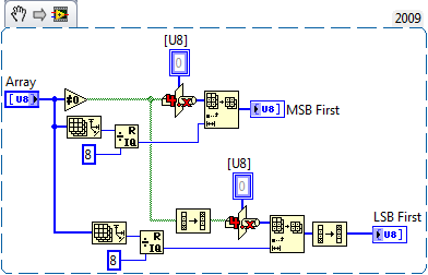

Sounds like this might work for you as well.  No need to convert strings into numbers.

Accepted by topic author josy
Is this want you wanted?

I'm still not sure if I'm understanding you properly.  But it sounds like you could do it with a simple shift register and build array.  I used a feedback node instead of a shift register in the example below.
