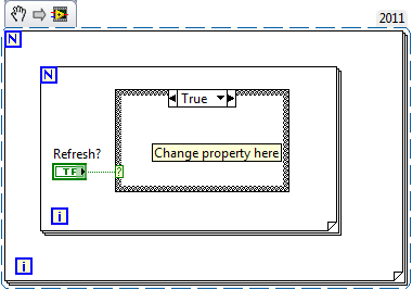

Visual representation of what altenbach told
Please don't put words in my mouth. I did not suggest at all what you are showing here! Thanks!

I think the image below explains a bit what Altenbach described above.
Please correct me if i am wrong.
I never said anything about a "refresh" button. 😮
I said "whenever a property changes". To see if the property node needs to update, you can compare it to the previous value using a feedback node. Here's a simple draft.
Note that the globally initialized feedback node start out with NaN to ensure that the property is written once at the beginning.
