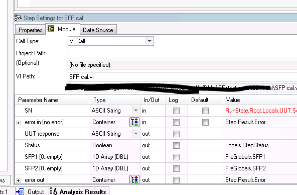

@NemoChen wrote:
I'm using test stand to call VI...
Are you including the project in the call of the VI in TestStand?  If not, my guess is the VI (which would be opened outside of any project context if you did not specify) will just use whatever symbol it used when it was last opened and compiled.
Message 8 of 13
(6,464 Views)
Hi Crossrulz,
Do you mean the 'Project path' in 'Module' of step settings?
I just leave blank.
So it's better include this item?
Message 9 of 13
(6,438 Views)
HI,
I just had some time repeat this problem and let me simplify it.
first of all i am using teststand call vi.
i have vi project, where i put the symbols on. and i have some vis in this project, which using the symbols inside (conditional disable structure)
what i can repeat are, 1, in labview window, i close all VIs, open only the VI project exploer. then i change the symbols by right click project and save the project.
then switch to teststand run sequence call VI which be included in that VI project. i can definitly say the symbol change does not take effect on the calling.
2, in labview, open project and VI front window. change symbols as normal. then save all ( actually if check at the 'list unsaved changes. it show VI recompiled. Although i did nothing on the specific VI, only open it.) and switch to teststand call vi again. that works.
What I simply want is, change the symbols only on project, save, then I can use test stand call all VIs. No need check each seperate VIs.
Does  it make sense?
