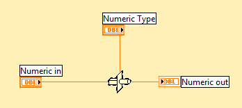

Selecting a Type cast and doing a quick drop remove connected the Type to the *type, instead of input to *type.

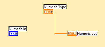

I confirmed this behavior in LabVIEW 2011 and LabVIEW 2015.  I also tried the new "Remove and Rewire" right-click option in LabVIEW 2015.  Both remove the Type Cast function and it's input, leaving the "Type" connection wired to the output.  I've included "Before" and "After" pictures.  I have a vague recollection of this being reported previously, with perhaps a note that this is "expected behavior" (but clearly not expected by either Yamaeda or by me) ...  Incidentally, if the input is a Constant instead of a Control, the Constant will also be "removed".

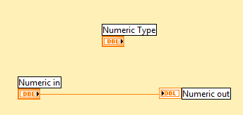

What the CSCR shorcut does is connecting identical types:
Screen Shot 2015-10-17 at 12.07.17.png=======>Screen Shot 2015-10-17 at 12.07.27.png
when it should connect input to output (not the type!). It just happens that for the Type Cast function, the current logic is going to do the "wrong" thing most of the time.

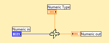

Not always though:
Screen Shot 2015-10-17 at 12.11.35.png=========>Screen Shot 2015-10-17 at 12.10.46.png
