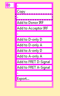

A neat feature would be to be able to use Ctrl-Space Ctrl-R to delete specific elements in an array constant.
In the example below, the selected element needs a Right-Click >> Data Operations >> Delete Element action to be removed.
The action needs to be repeated as many times as elements that need to be removed.
Unfortunately, it is currently impossible to select more than one element at a time, but obviously this would be even more powerful if/when multiselection were/will be supported.

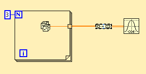

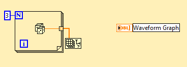

If I do Ctrl-Space Ctrl-R on a reshape array like so:

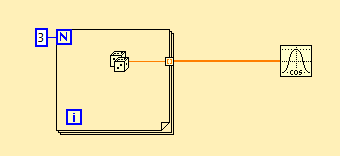

I get this:

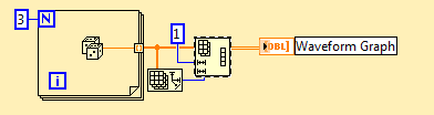

while I was hoping to get that:
Message 116 of 120
(2,307 Views)
In your top image, your graph is a 2-D array.  In your bottom image, you want the graph to be a 1-D array.
Why do you expect the Ctrl-Space Ctrl-R to not only remove and rewire something, but also change the datatype of the resulting terminal?
Message 117 of 120
(2,302 Views)

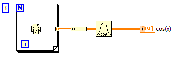

Magic?
Like here:
gives this:
Message 118 of 120
(2,289 Views)

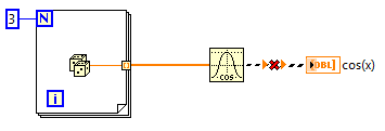

I don't think you are comparing the same functionality. In your example, the cosine function is polymorphic. You can wire up a scalar, array, etc, control and the function can handle the datatype accordingly. However, if you add a 2-D arrray indicator at the output of the cosine function, you get a broken wire on the output terminal. The Ctrl-Space_Ctrl_R does not change the datatype of the resulting terminal. IMO for this example, it is working as expected.
Before
After
Message 119 of 120
(2,256 Views)
The data types normally must match exactly (except for numeric coercion). The reason the Sine example above works is because it's a unary function, and Remove and Rewire treats those special...it will try to wire the input to the output no matter what the data types are if there are only one of each...this is a feature we discussed years ago in this very thread.
So a workaround to the current issue would be to delete the two index input wires to the Reshape Array before using Remove and Rewire. It's the best I've got at this time. Perhaps a future improvement would be to see if the sink terminal that would be wired is a graph, and if so, relax the array dimensionality matching requirement, since graphs can be 1D or 2D.
