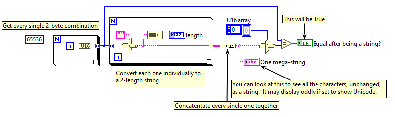

This is false and if you run the following code it can prove it:
Now, I will grant you that LabVIEW's support for Unicode is a bit lacking, and it's .NET interfacing *might* be related to the problem you are having, but since you have yet to show any ACTUAL details, we can't see what you're doing and offer suggestions for workarounds.

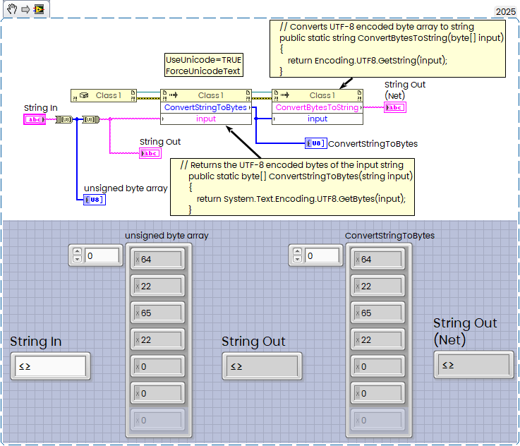

@Kyle97330 wrote: 
Now, I will grant you that LabVIEW's support for Unicode is a bit lacking, and it's .NET interfacing *might* be related to the problem...
It seems to be not so bad in this particular case, I checked this as shown below:
