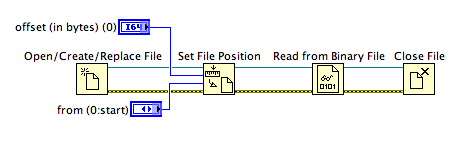

Use the open file function.  The Set File Position and Read from Binary File functions can be inside a loop if multiple reads will be performed.  (The image is from LV2009 but I think the functions are the same in 8.x).
Lynn

Should I have "close file" VI?
Jay
(4,529 Views)
Jay,
It is always safe to close each reference which has been opened.  In some cases it is important to do so to prevent memory leaks.  LV can do a pretty good job of closing references on its own, but it is not clear when it does so and when it may not, so closing explicitly is preferable.
