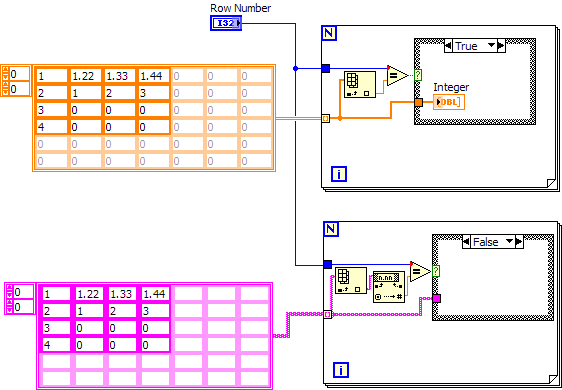

Here is a method for either.
Tim
GHSP

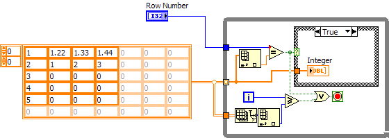

Here is another type that will stop as soon as it finds the correct value.
Tim
GHSP

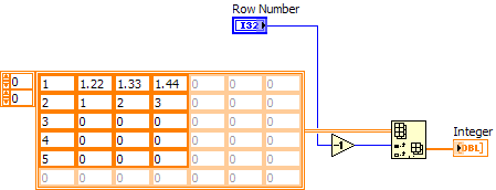

Here is another version where aslong as the rows will be in order it would work.
Tim
GHSP
