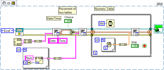

Here's one way ...
The first bit of code uses the Get Date/Time String to get Date and Time.  I use Excel Easy Table, as I find it "easier" than Append Table to Report.  I've brought the two outputs on "Where to put the next Table" out with a Choice switch so you can see how you want to place the Numeric Table.
For the Numeric Table, I first generate the Num1 .. Num10 Headers using a For Loop and Format Into String, writing it out as a single row.  I then enter the While loop and generate a single row, adding it at the bottom of the existing Numeric Table until the Stop button is pushed.

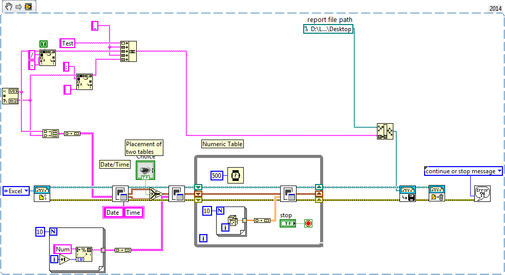

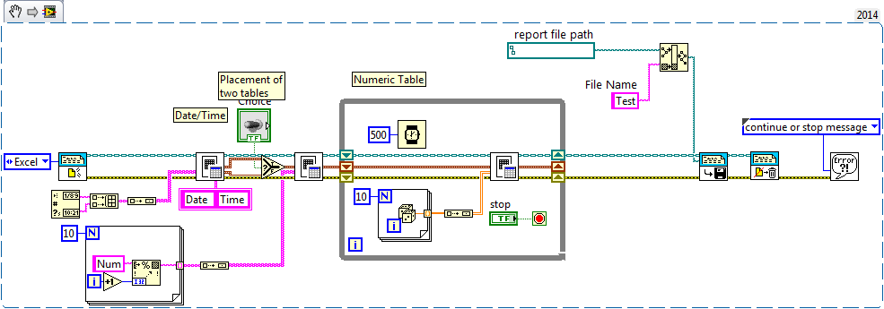

Refer this snippet to save this report.

I'm not getting how want to save the report. give me example of your file name.
By the way, you can build your own file name & pass it "Save the report.vi".

as I told, you can build your file path. Refer this snippet.
