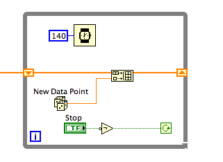

I am not sure I fully understand what you are doing.  The image below shows how to add a datapoint to an array (using things available in LV 5.1).
Also you should stop your loop with a control or some logical condition.  Wiring a constant to the conditional terminal means that you must use the Abort button (red octagon) on the tool bar to stop the program.  That is bad practice because it leaves things in an indeterminate state.
Lynn
