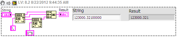

I tried and I tried but I couldn't crack it with one regular expression, so I took the easy way out.  The first Match Pattern finds the decimal point and the second one clears trailing zeros from the rest.  It doesn't discriminate between numbers and everything else, though.

@jcarmody wrote:
@Z.K. wrote:
[...] or some other way.

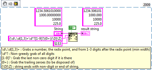

Well, since you asked my quick answer is to not look at which parts to grab from the string, but rather which parts to eliminate.  I would go with a Search & Replace:
My usual taste is to leave at least one zero after the radix point (ie. 1000.00000 becomes 1000.0), so what I show here uses a minimum width.  The example as written gives a minimum width of three digits after the radix point (if the original number has more than three).  You can change the number 3 to be any minimum width you like, or remove the quantifier for a min width of 1. (\d{1,3}+ becomes \d).
Edit:  Added bonus, as you see it will do the deed to multiple numbers in a string without a loop.
Edit 2:  Would I really do this using a Regex, maybe not, but the point here is that it could be done.
